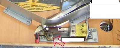

HI heavy metal meltdown is a multiball - 1 ball is stuck at the bottom of the table - it has not been moved to the right and the flipper thinks the ball is still in play. The mechanism for moving the ball has a loose wire i think because for a few days i was able to touch things underneath and the ball would clear and the game would continue but now nothing happens. I hope you understand !

Hi Mayflower,
I don't especially know this pinball, but it seems that the pinball doesn't see the ball as lost and it's probably a switch problem.
I suggest you to check thie switch in the red border of this pic :
(It's not a Heavy Metal Meltdown playfield but it's a same pinball genereation's playfield, so it should look similar).
Keep us informed ;)
